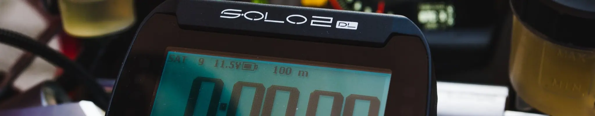

SOLO 2 DL
What is the best track day lap timer?+
The Aim Solo 2 DL is a high-precision, 25Hz GPS lap timer. It connects directly to your vehicle’s ECU to provide detailed performance data such as speed, RPM, throttle position and more. It provides accurate lap times, split times and predictive timing, with advanced data logging capabilities, making it one of the best compact data logging lap timers with an integrated display for track days.
How does the Aim Solo 2 DL motorsport lap timer work?+
The Aim Solo 2 DL is a GPS lap timer that allows you to analyse instant speed, timing splits, live data and predictive, theoretical and delta times. It connects directly to the car's ECU and multiple satellite constellations (GPS and GLONASS), providing performance data in real time.
What technology does the Aim Solo 2 DL use?+
The Aim Solo 2 DL uses a range of different technologies to enhance user experience. It has a 25Hz GPS receiver for precise lap timings and position markers, a 100Hz 6-axis inertial platform that provides data on roll, pitch and yaw. It also has integrated data logging capabilities via CAN bus, for advanced and comprehensive data collection.
How do you connect the Aim Solo 2 DL to the car’s system?+
The Aim Solo 2 DL manages all the hardware ECU connections as well as all the communication lines: CAN, RS232 or K-Line. Choose between the CAN/RS232 external power cable, CAN/K-Line/external power cable with the OBDII connector or RPM/external power cable. If your car doesn't have an ECU, you can connect the Solo 2 DL to an RPM wave to synchronise RPM to the position on the track thanks to the RPM power cable.
