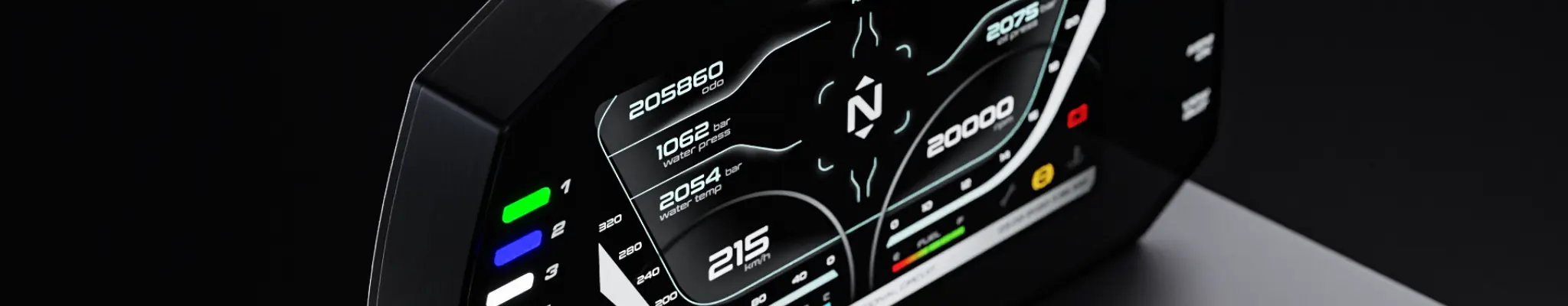

What does the MXG Strada do?+
The Aim MXG Strada is a digital dash display that can be configured to show real time information from the car's ECU, analogue/digital inputs, predefined math channels and an optional GPS Module. It provides crucial information like lap times, gear, speed, RPM and engine temperatures on a high-contrast TFT screen.
What size is the MXG display?+
The MXG features a 7", 800 x 480 pixel resolution display, making it one of the smallest displays in the MX Strada series.
What alarms can be set on the MXG Strada?+
The MXG Strada comes with 8 customisable RGB LEDs, which are determined by inputs from the car's ECU or other sensors. The MXG Strada with race icons can be configured with alarms for gear position, lap time improvement, throttle position, low fuel, low oil pressure, low oil level and other customised alarms that have been set.
