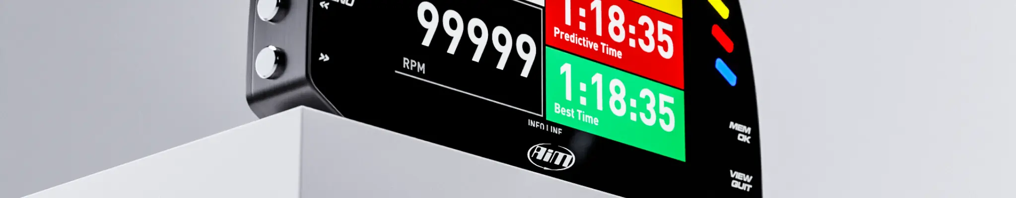

What size is the MXS Dash Display Logger?+
The MXS features a 5", 800 x 480 pixel resolution display, making it one of the smallest displays in the MX Logger Series.
What alarms can be set on the MXS Display Logger?+
The MXS Display Logger comes with 6 customisable RGB LEDs, which are determined by inputs from the car's ECU or other sensors. The MXS Dash Display Logger can be configured with alarms for gear position, lap time improvement, throttle position, low fuel, low oil pressure, low oil level and other customised alarms that have been set.
